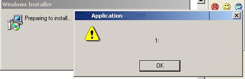

In Addition to this : With the Arguments : /I {Product code} /qf
if tryto remove from shortcut
windows installer pops up the Dialog showing " 1:" message and abort. (see the attachment)
as per the Help /qf is used for FULL GUI option. i dont know how to do this? am i doing anything wrong ?

/x removes in basic UI mode (or in silent mode, not sure).
InstallScript MSI rpojects can't be run using msiexe. Instead you have to launch setup.exe.

Posted 28 December 2005 - 12:16
You could use the same command that's written in the uninstall registry key.
