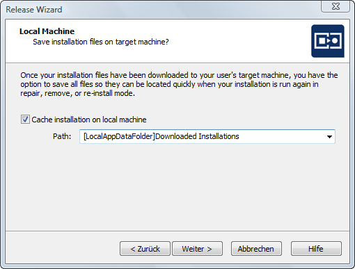

Interestingly, I didn't know you can change the default location where an MSI is uncompressed. How can I do that?
Thanks
Posted 31 January 2009 - 17:49
You can set this in the release wizard (see attached screenshot). The new default is now [LocalAppDataFolder]Downloaded Installations
