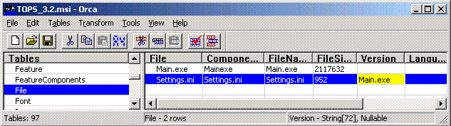

Hi forum,
in my installation there is an unversioned xml-file installed. I currently use Wise, which creates an hash for this xml.
I want this xml to depend on the existence of another file within the installation, a versioned dll file.
So if the dll file will be deinstalled, also the xml should be deinstalled - even when the user changed something in it.
The reason is, that our software's architecture is not final yet, so that specific files need a specific 'version' of this mentioned xml. I must be sure, that always the correct xml-file is installed.
How can I do this? And, if you know, how can I do this using Wise?

Ok, solved. Companion file is the key.

| QUOTE (Glytzhkof @ 2006-08-31 13:33) |
| That's right, see attached image to see how this looks in the MSI. Essentially you just add the name of the versioned file to the Version field of the unversioned file. |
Thank you very much,
Regards,
