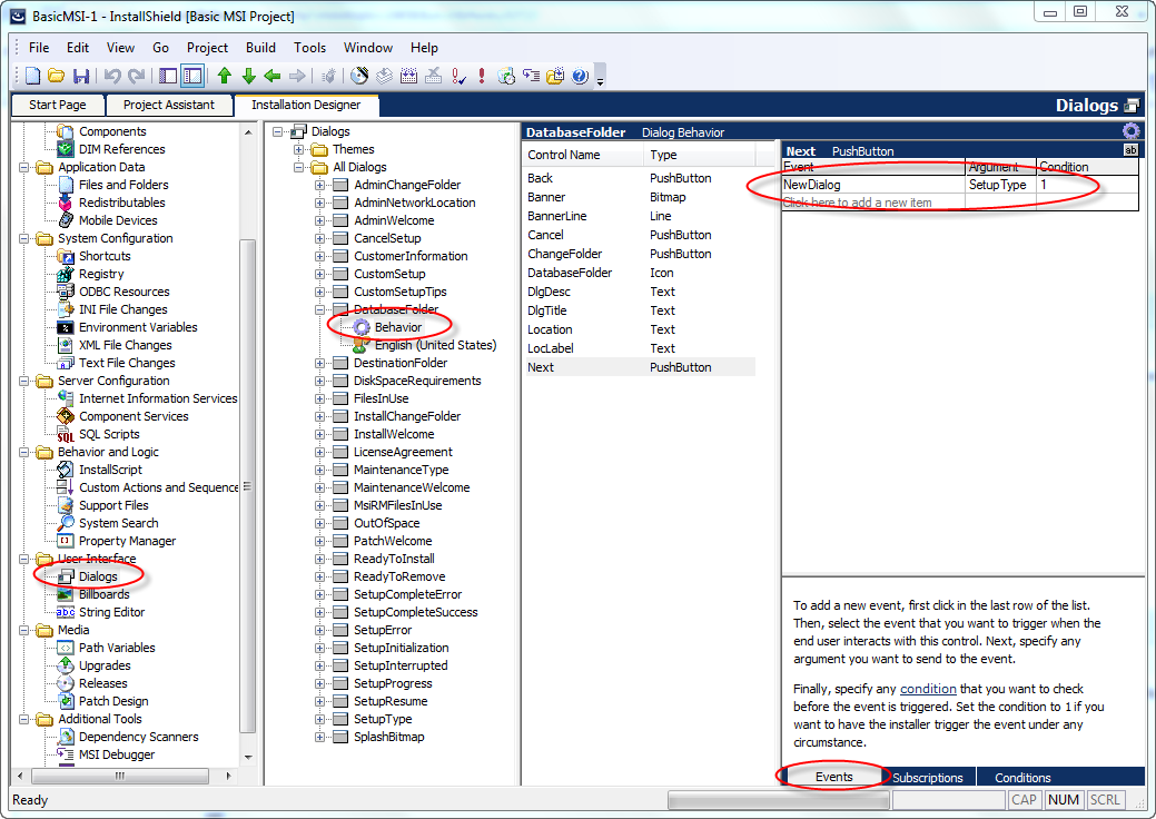

Please see the attached screenshot. You can add a second NewDialog row, to display an error dialog (which you need to create, too). Instead of condition "1" in the screenshot, use mutually exclusive conditions for the two rows. You can use the property that's associated with the Edit field as condition. It will be true if the property isn't empty. So your conditions would look like this:
Event | Argument | Condition
NewDialog | ReadyToInstall | EDITPROPERTY
NewDialog | ErrorEditEmpty | Not EDITPROPERTY
Replace ReadyToInstall with whichever dialog you need to display if everything is okay.
Replace ErrorEditEmpty with the name of your error message dialog.
Replace EDITPROPERTY with the name of the property associated with the edit box.
