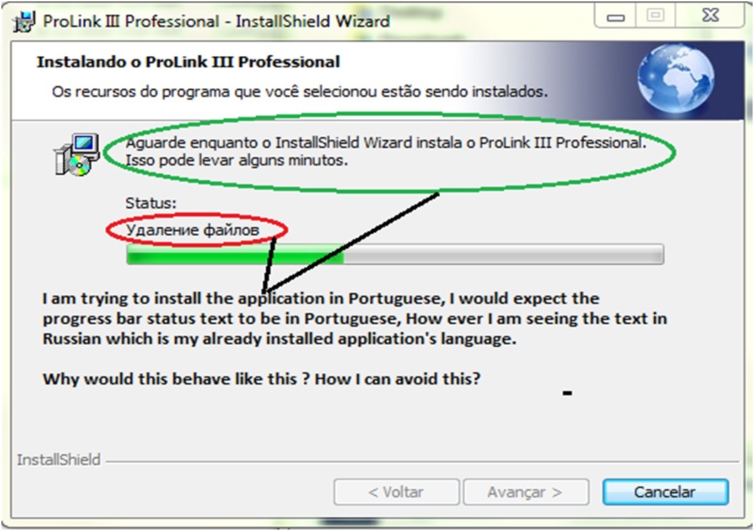

For eg : I have installed my application in Russian language, and I am doing the major upgrade. It prompts the language dialog and I select the German. When installation continues, all the dialog appeared in German, when application installation progress messages are appearing in the Russian language (that means my older transformation file) I would expect the language to be in German which selected before starting the installation.
If I see the log file, when performing the custom action it try to access C:\Windows\Installer\{Product code GUID} and pick the 1049.mst file. I have no idea why this is behaving like this.
I believe I am missing something to handle the different language installation.
Please help how I can resolve this issue.? I would like to see all the text in one language not in mixed language.
I have attached a picture, It will give more clear idea about my issue.
